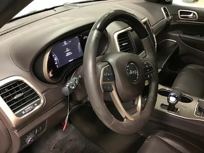

A few weeks ago the "easy exit" raised steering wheel feature in my 65k mile '14 Summit quit working, but the seat still goes back. In fact, the wheel is stuck in the completely raised position and cannot be moved down even with the switch. Makes it funky to drive. The forward and back portion of the switch works fine, but no up or down.
I have done a net search and found very little answers to this problem. Some say the dealer wants to put a new steering column in it, big $$$ because the power motor is part of the column. Others have said just remove the plug to the tilt motor and plug it back in. I tried that several times to no avail. Anyway, just curious if anyone on this forum can give me any other options. Thanks in advance.

I have been looking on Car-Part.com for used columns and contacted a couple of yards but still waiting replies. Pretty sure that's about my only avenue to pursue. Yes, from good clear pics I have seen on an ebay link, it looks like it would be a total bear to replace the motor if not impossible. There are two motors on the column, one for in/out the other up/down. I have disconnected and reconnected both with no luck.
Evidently this isn't a big problem with these columns as I cannot find much info on a common culprit. Which makes getting a used one not as much of a crapshoot if it will work or not. I worked on cars for a living as a heavy collision body tech, but I retired 6 years ago and my body isn't used to diving under dashes any more. My back is hating life right now. If I do find a good column, I will probably just pay someone to replace it which I hate doing. Oh well, such is life.

In the few links I did find concerning this issue, some did say it was that simple. I did disconnect the plugs going to each motor, which did nothing. I will get back under there and look for a larger harness. Will probably shoot the plugs with some contact cleaner also.

The one I ordered off ebay is the same year (2014) and model (Summit) as mine with 6k more miles on it. Couldn't pass it up for the price. Supposed to be here next Wednesday.
